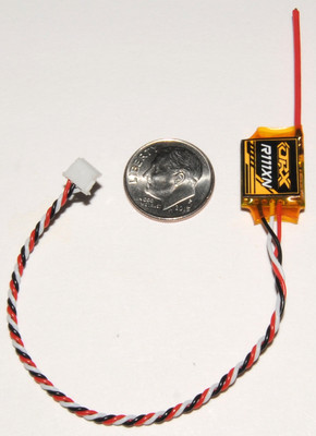

ESC/Flybar unit is in the front and if your running this on a spektrum system like me the ONLY place to put the satellite is where I have.. you have a convenient space in the frame to run a safety tie-wrap otherwise the double-sided tape would be only holding on the outside of the frame and the middle section would be hollow so to speak.
