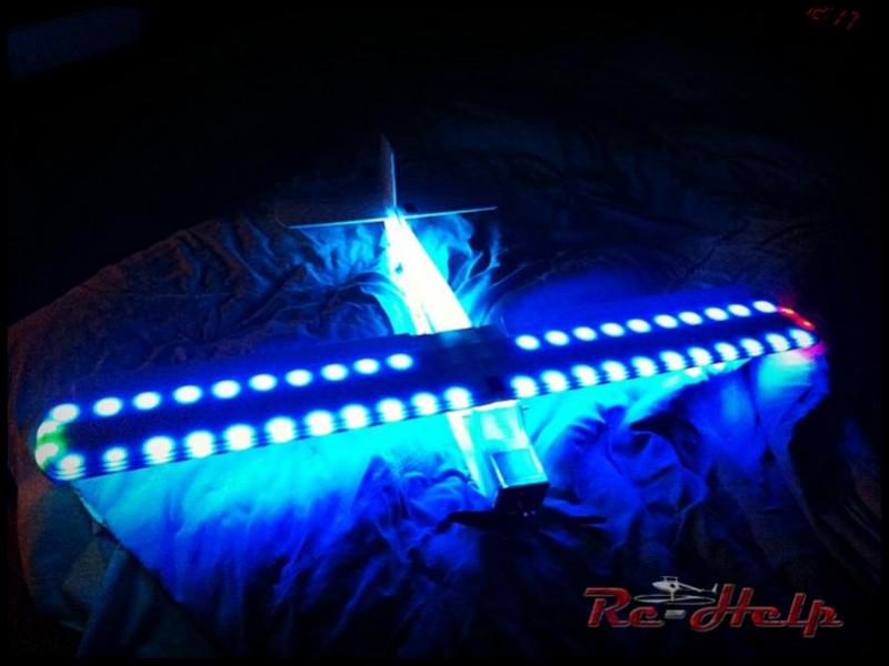

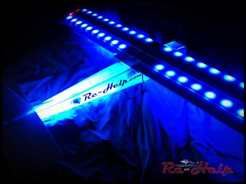

Maybe if I get some time I will show you guys how I created the plane below!
