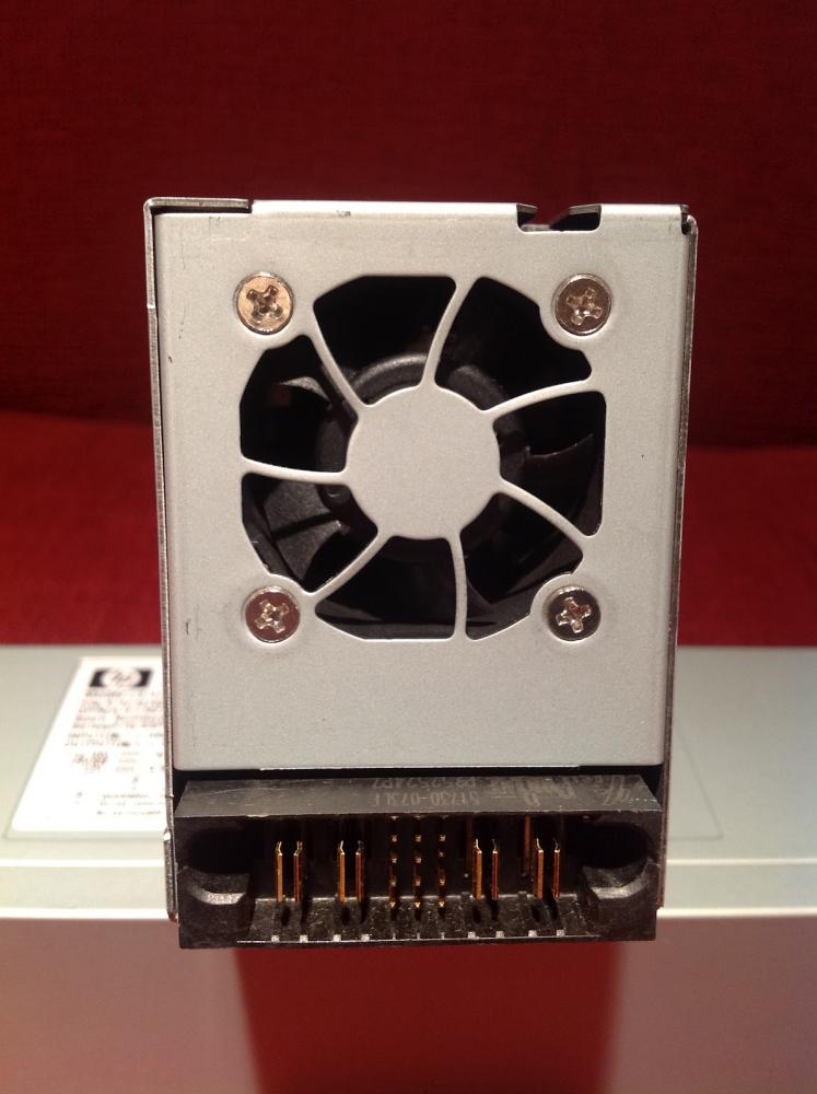

Alright this is what the supplies look like:
See the 12 pins in the middle of the connectors on either side ? That’s where the magic is to turn these on. And to control fan speed… This is what each pin does (as far as I know):

And this is my drawing of the front face of the supplies, with required connections (my drawings are not pretty.. but that’s not what they are there for..
they are for information. So bear with.. )
So as you see to turn on the power supply we are shorting pins: 6 8 and 10
8 being ground, we are tying PsKill and PsON to Ground. This will turn your power supply ON and if you put the multimeter across the two terminals on either side, you should read 12V or may be even 12.9V out.
