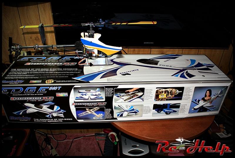

When this plane first came out back in '08, there were many problems with broken spars in the fuse, and even more reports of broken rudders. This was not the case with my plane. Everything came out of the box in perfect shape. The MonoKote is some of the best that I have seen. Only a couple very slight wrinkles in the whole plane. It was overtightened on one of the elevators and actually bent the wood out of shape, but this is an easy fix with a heat gun.
So what do we have when we open the boxes? Yes, I said boxES. Everything came in a large box. In there was another large box, and all of my extras that I ordered. I took all of the stuff out of the outter large box. I noticed that the big box inside the large box was opened. Oh goodie, something is going to be missing. I look in the big box, and there is the box with the plane in it. I know this, because it has the pictures on the outside
