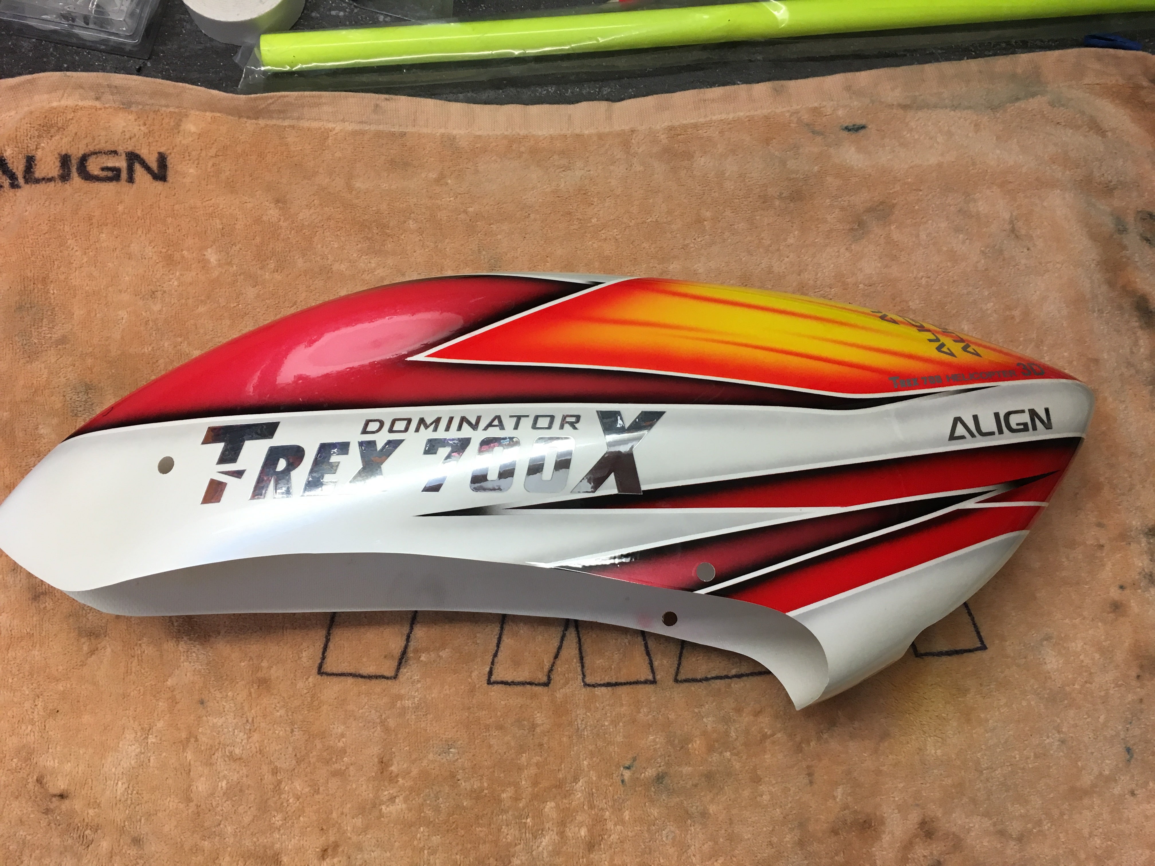

So you need a canopy:

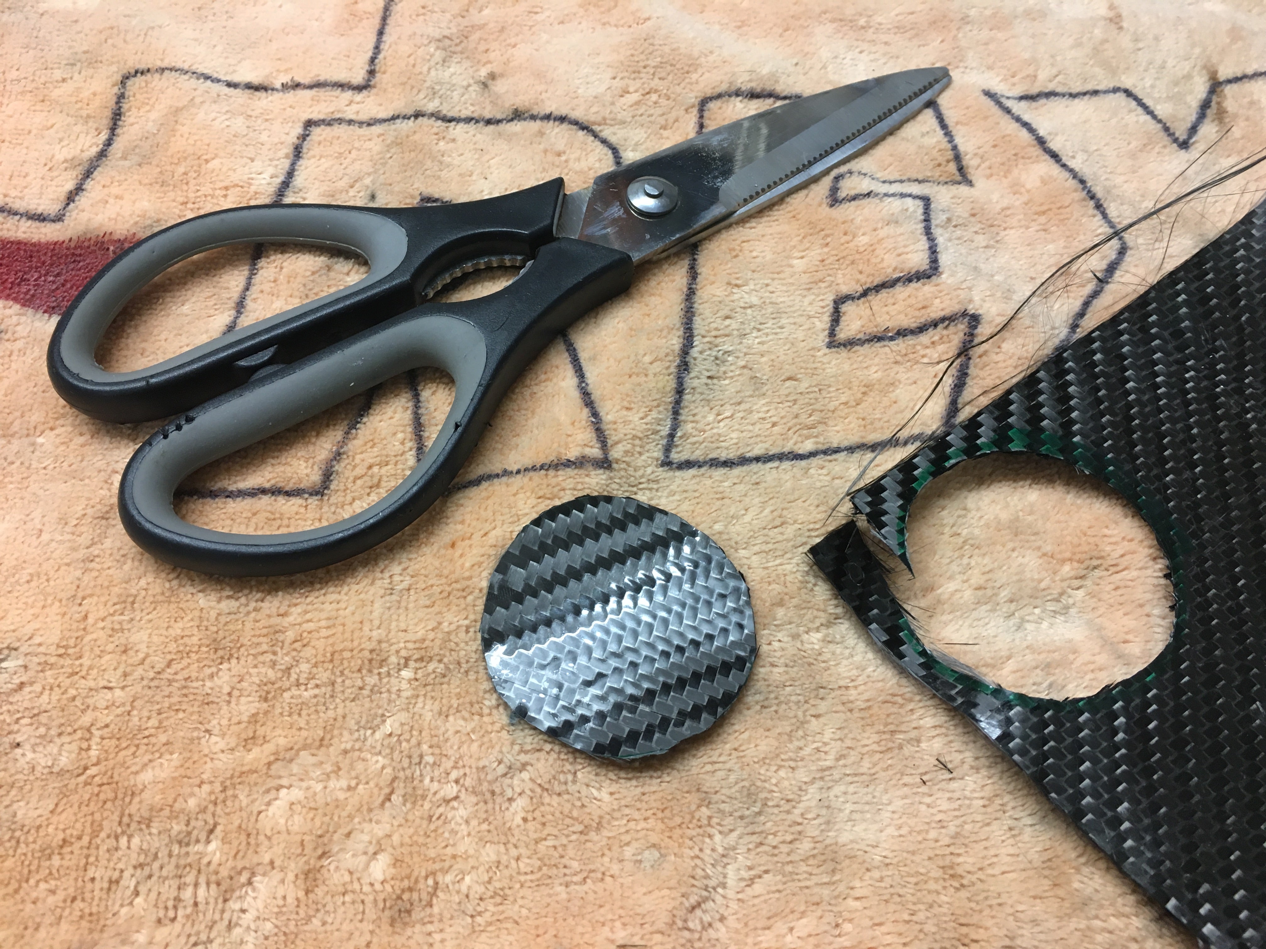

Mark and cut out patches:

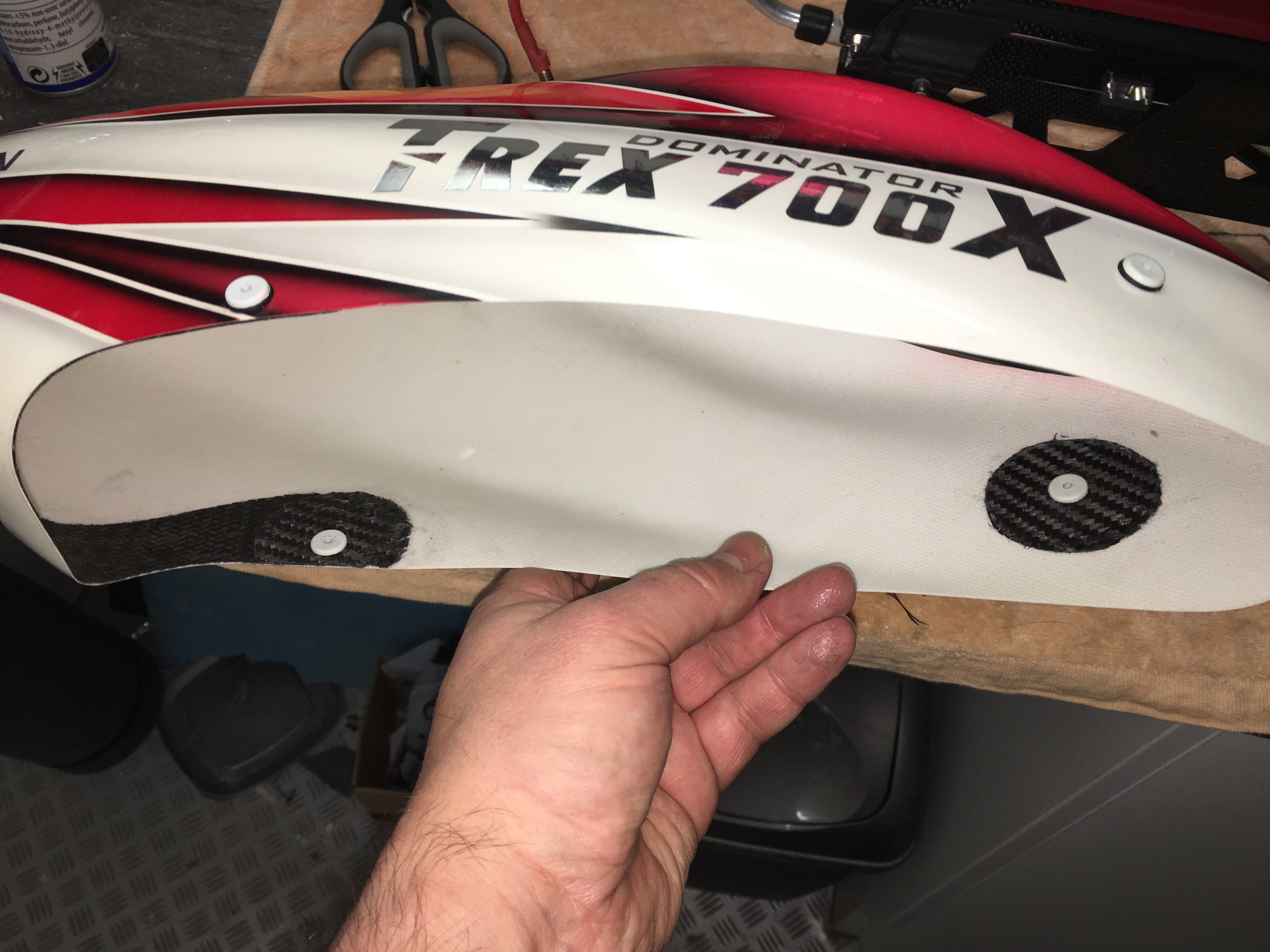

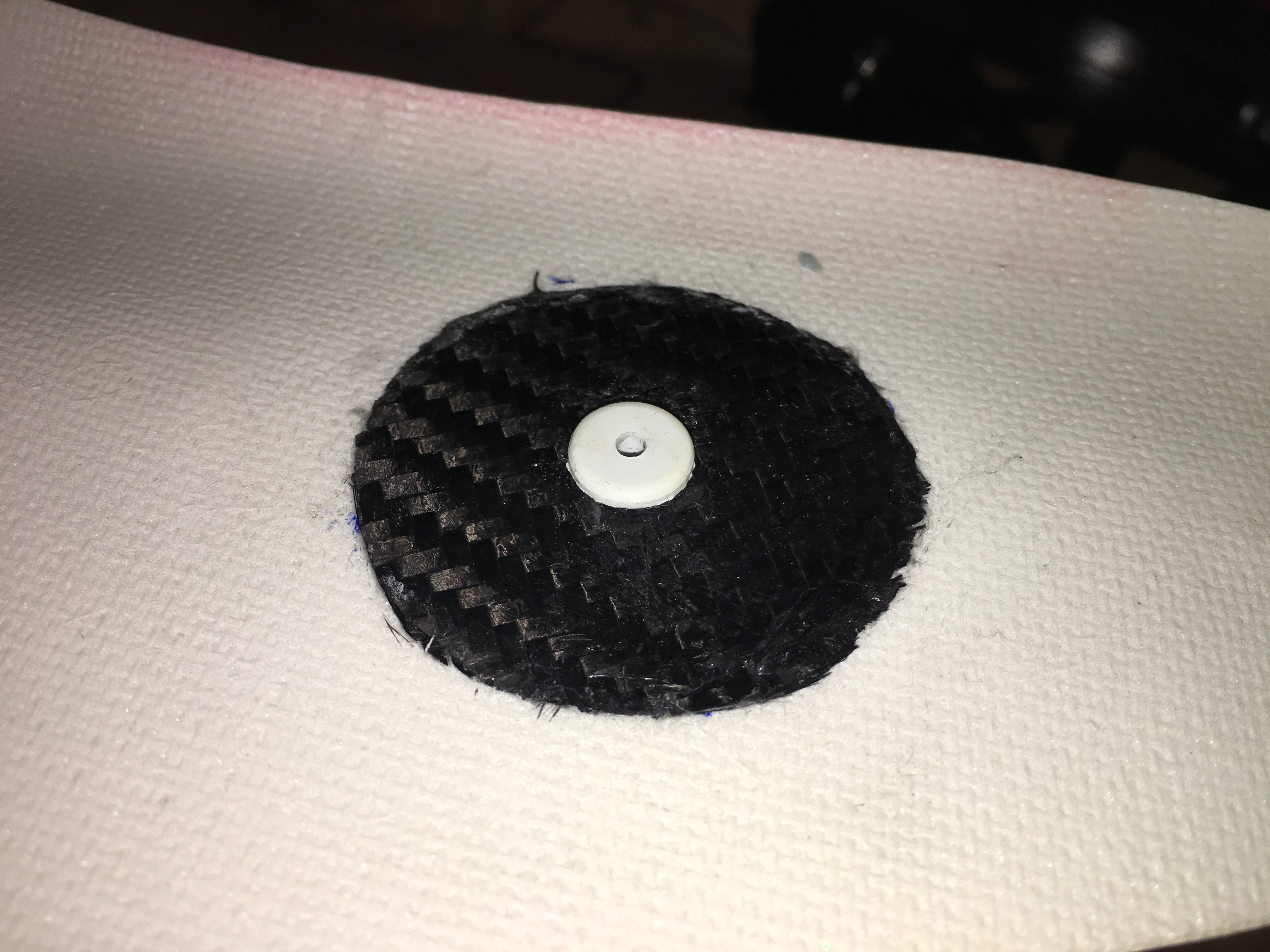

Seal off the grommet holes on the outside with tape to stop the CA running through. Mark the inside of the canopy with a few dots to show where the edges of the patch will be. Apply CA glue to the inside of canopy and press the patch on. Be really careful to not let the CA run or get CA fingerprints on the canopy.
It's a good idea to have some CA de-bonder handy just in case as it's almost inevitable some CA will get on the paint finish::thumbup:

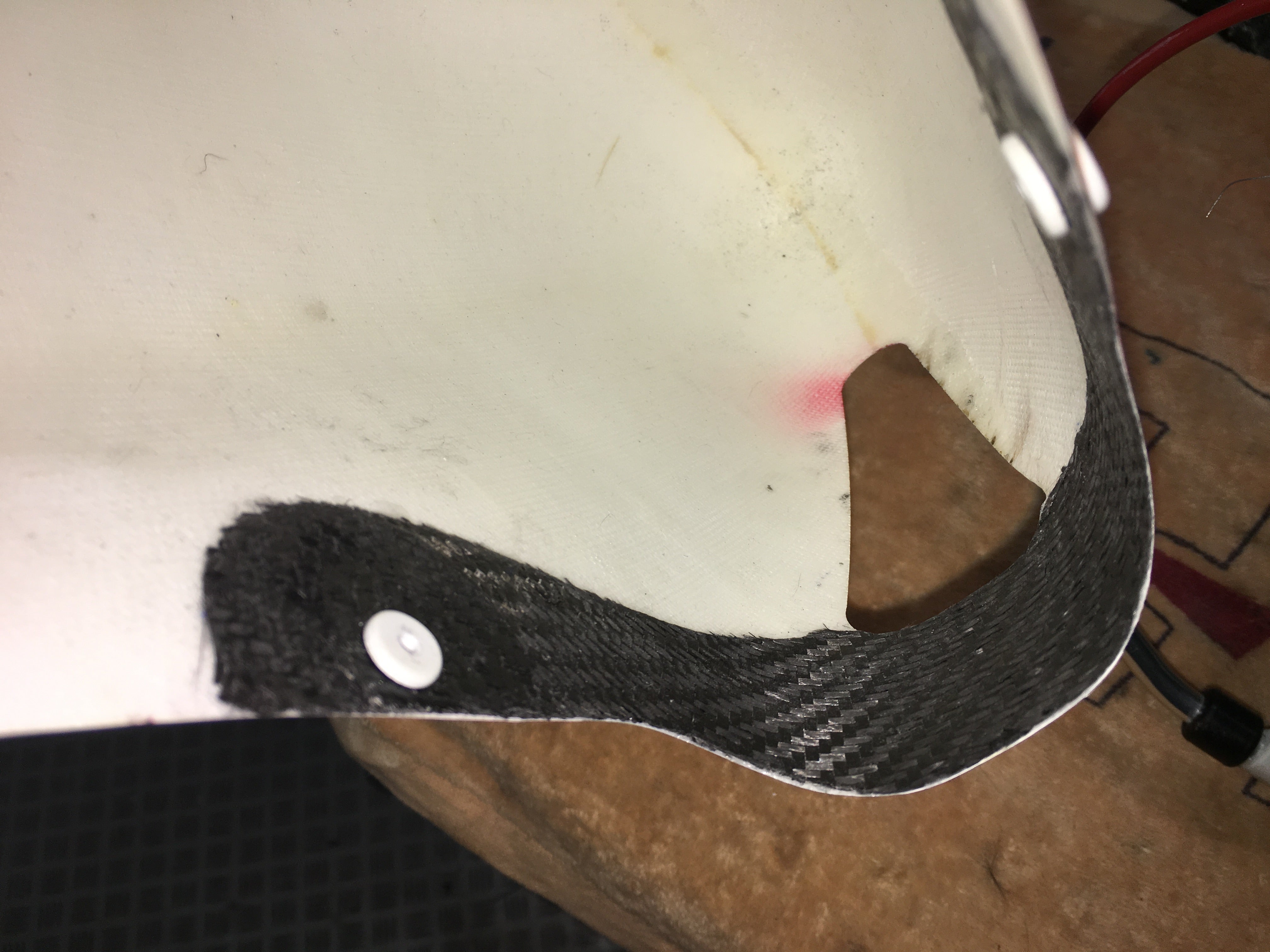

I extend the patch along the 'chin' to stop it cracking there:
The finished canopy is a lot stronger and the patches dont add any significant weight. You can leave the tape on or remove it, your choice.:
