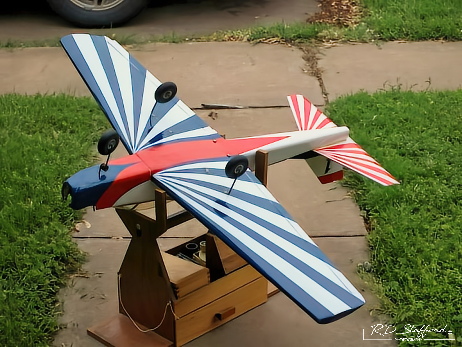

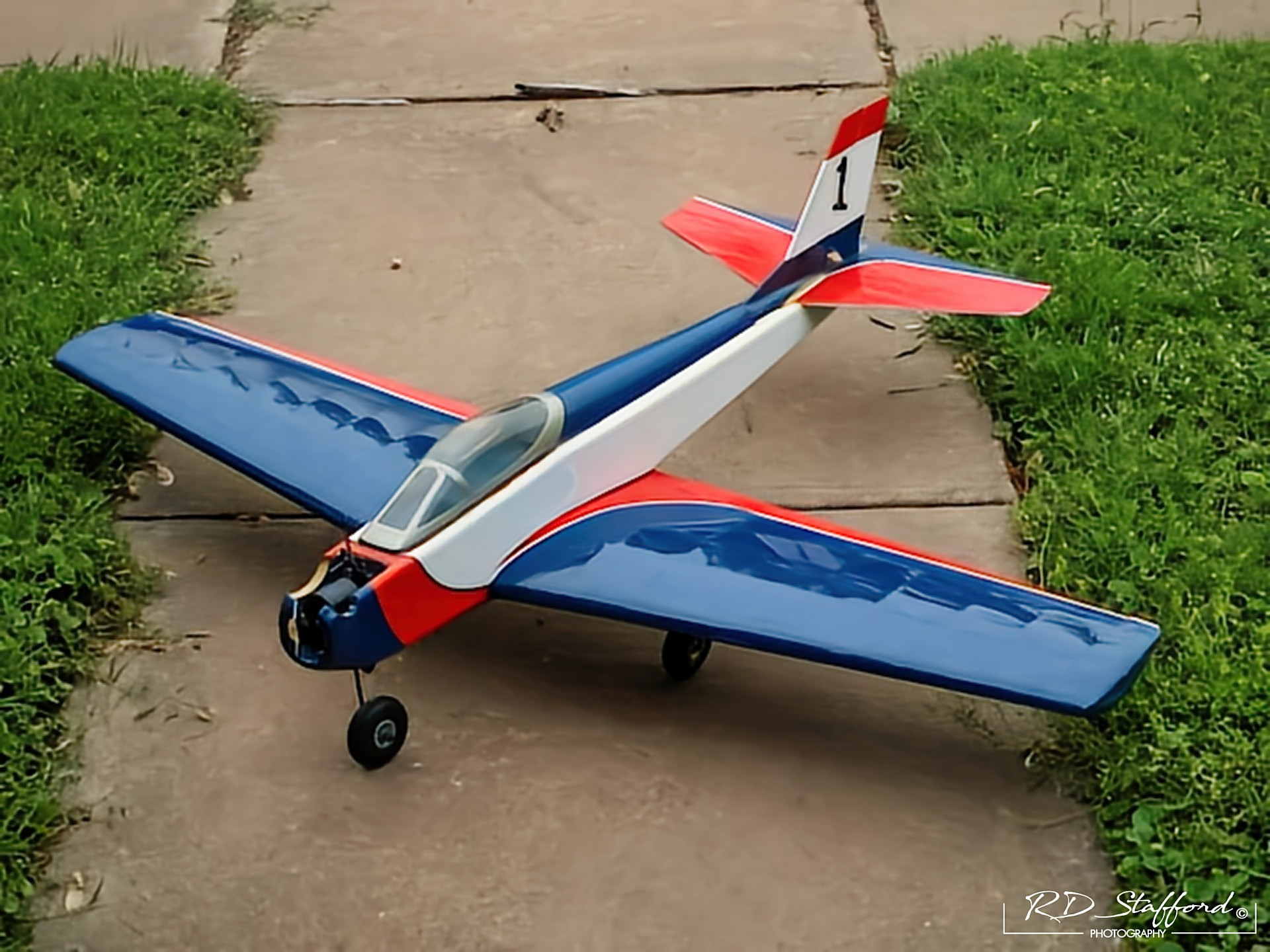

While I'm at it... here are two pics of the second airplane I had built ( but never flew ) back in the mid 70's... which reminds me of another tip. Trim tape, can cover a lot of crooked cuts... lol
