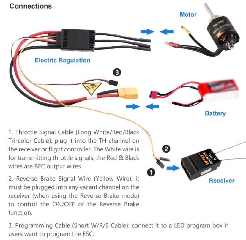

I got the brand new FMS Viper and trying to convert it into Digital FPV plane. I soldered the ESC's power and signal wires to the flight controller. And flashed the flight controller with INAV 6. I calibrated the ESC but the problem is that the motor isn't spinning and keeps beeping every second. On the radio transmitter, throttle min is trimmed at 1000 and max is trimmed at 2000.Here is the video demonstration of the problem:
ESC: FMS PREDATOR 120A BRUSHLESS ESC WITH 8A UBEC & REVERSE BRAKE FUNCTION
Motor: FMS 3670, 1950 KV inrunner
Flight Controller: MATEK F405 WMN, firmware: INAV 6.1
Radio Link: TBS Crossfire
Radio device: TBS Tango 2
ESC is equipped with 3 cables: Tri-color Throttle Signal Cable, Reverse Brake Signal wire, Tri-color Programming Cable.
However, I soldered only signal (white) and ground (black) wires to my flight controller's S1 and G pads as shown below. I don't need thrust reverse though.
Anyone can advise why the ESC keeps beeping every second and motor won't spin even after calibration?

I'll also briefly mention to look at your ESC manual, it lists some troubleshooting and there are 4 beep codes that give the similar error you are getting indicating you are NOT calibrated. I suspect it's one of the last 2 error beep codes but they do not describe the differences in the beeps... one states the end point ( probably lower throttle ) wasn't seen... the other that the range is too narrow. Basically, it's sort of pointing back to the software setup not being completed but since the ESC can't tell you are using a FC, it gives those codes.
Solved!
I have soldered thrust-reverser wire to one of the spare PWM outputs of my FC and it worked! The motor spins now.
