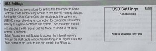

I admit that it sounded like I was talking about the computer, but I was in fact talking about an option in the NX8 Functions screen. I attached a picture of the bottom of page 25 of the NX8 manual where it explains (sort of) what is going on.
I'm guessing now but the transmitter either came with this setting on Game Controller mode or switched to that mode when I plugged in the USB cable between the NX8 and the computer (iMac). Anyway it was my fault for not reading the manual all the way to page 25.
