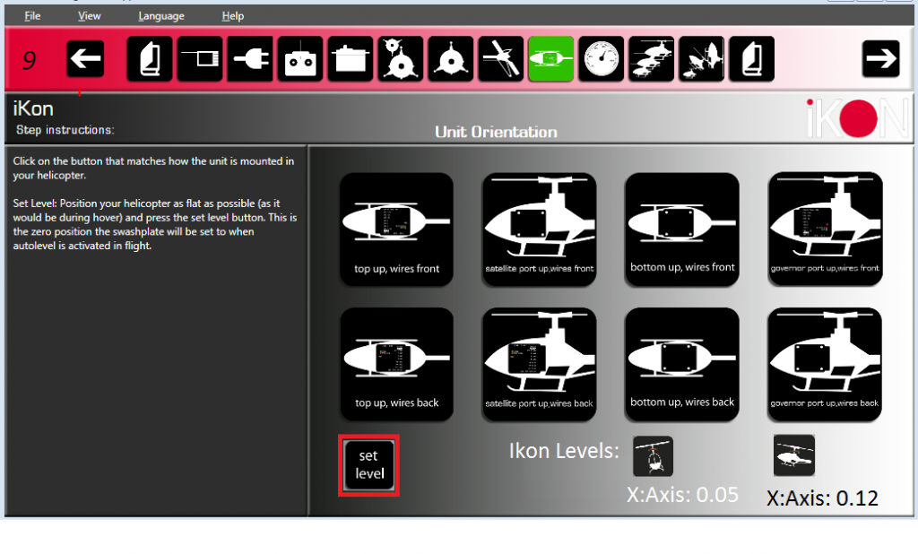

4. Add another area to section 9 to the software (move the Set Level Button to the Left) Showing the user the actual readings the Ikon brain is seeing as level Y +&-100 and Z + and - 100.... as you move the heli for levelling ... you can see the Ikon sensors working.
That way you can reference the Ikon level compared to a bubble (real world) level.
Like this ....
WHOOPS .... I GOT THAT WRONG .... X and X ... hahahah ya got the point though right Lol

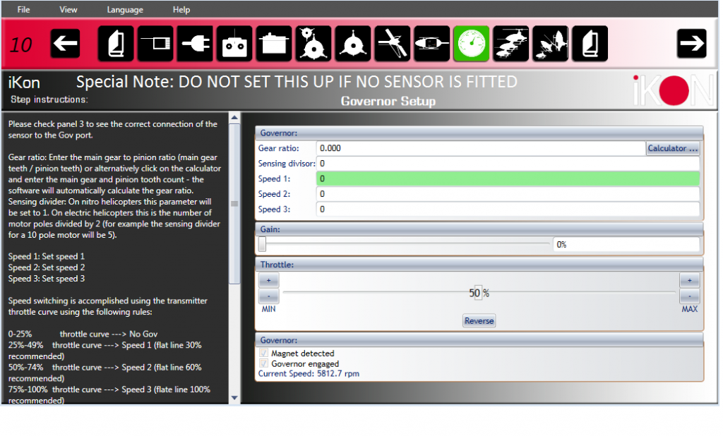

5. in Level 10 (governor) explain that if it is not used ..... no set up is required.... you know ... as simple line across the top saying "DO NOT SET UP IF NO SENSOR IS FITTED"
lIKE THIS:

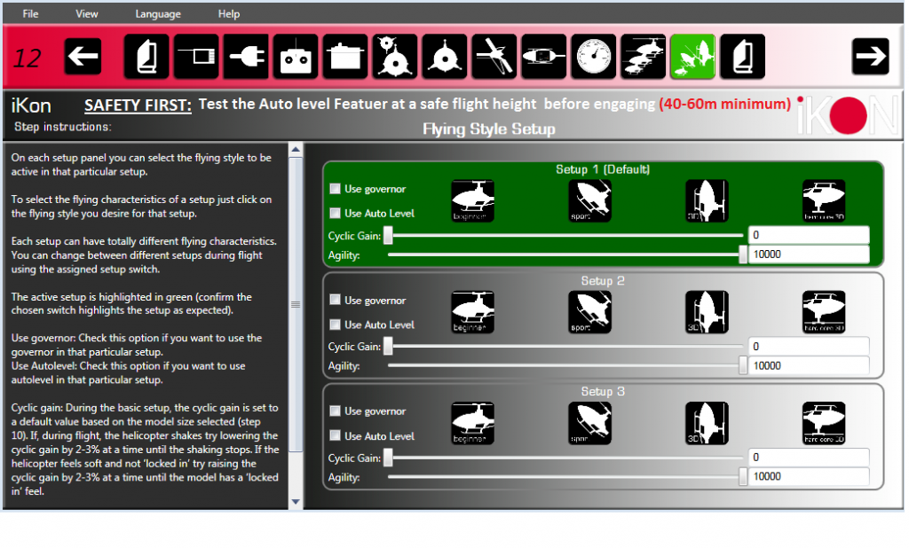

6. THE FLIGHT MODE section, put a line of Txt at the top saying .... Test the Self level at a safe flight height no less than 40 meters before engaging.
