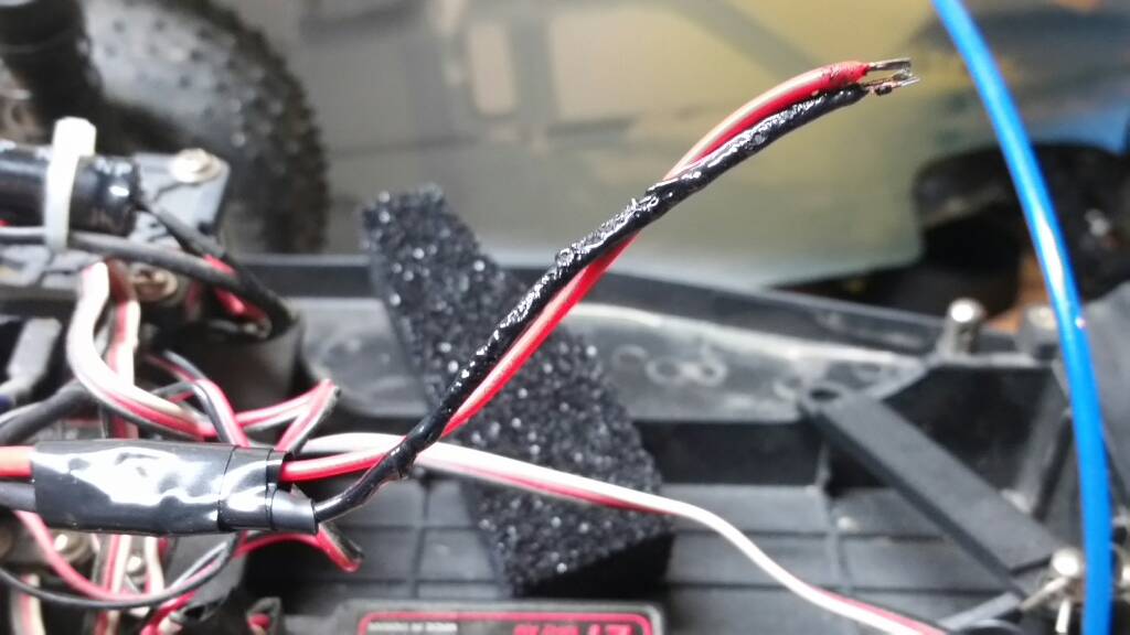

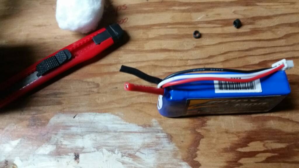

Well I got lucky...JST is not the way to go on this buggy...
I ended up cutting the battery free before I ended up with a fire....
At a bare minimum EC3 with equivalent wire.
Oh, if I knew you were using that kind of connector and wire, I would be yelling lmao. Yeah, that is way too small for that truck. The motor in that truck is going to pull 50+ amps. Way more than that little plug can handle. EC3 or Deans is what I suggest.
And nope, not too short to solder. I can't remember if you were the one to get the Hakko soldering station, but if you are, this is the perfect reason why you need it.
