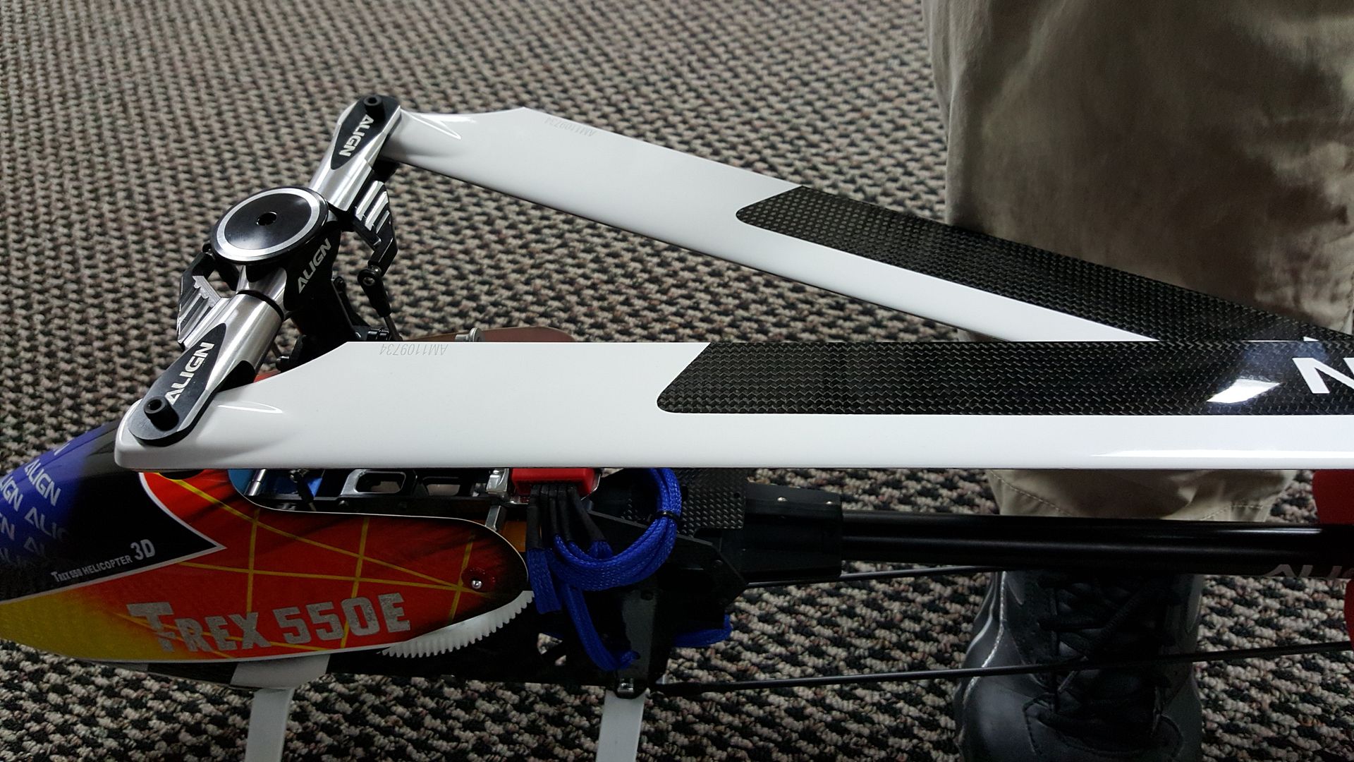

Hi all. I hope everyone is well and had a good holiday! I am making progress with my 550.. I scrapped the align ESC for a Talon 90 and the 3GX for an IKON.
I just need to dial everything in, get some flights and then on to the next phase of this project.

Thats a very nice tidy wire job!
Thank you! It took me forever to wire it the way I wanted to. I bought the wiring cover from Heli direct and it took me several trys on how to use it. I think I finally figured it out. I am thinking about getting the bluetooth adapter for the IKON so I can mount it underneath, which would make the wiring even cleaner. You know how it is.. forever modifying.. LOL
