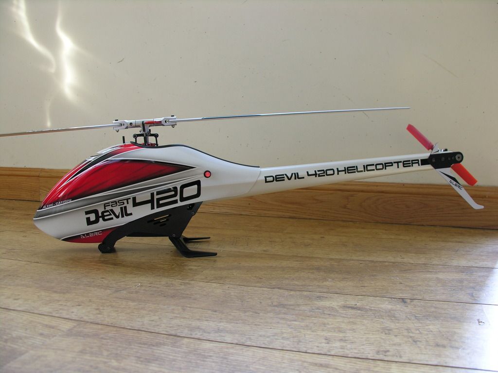

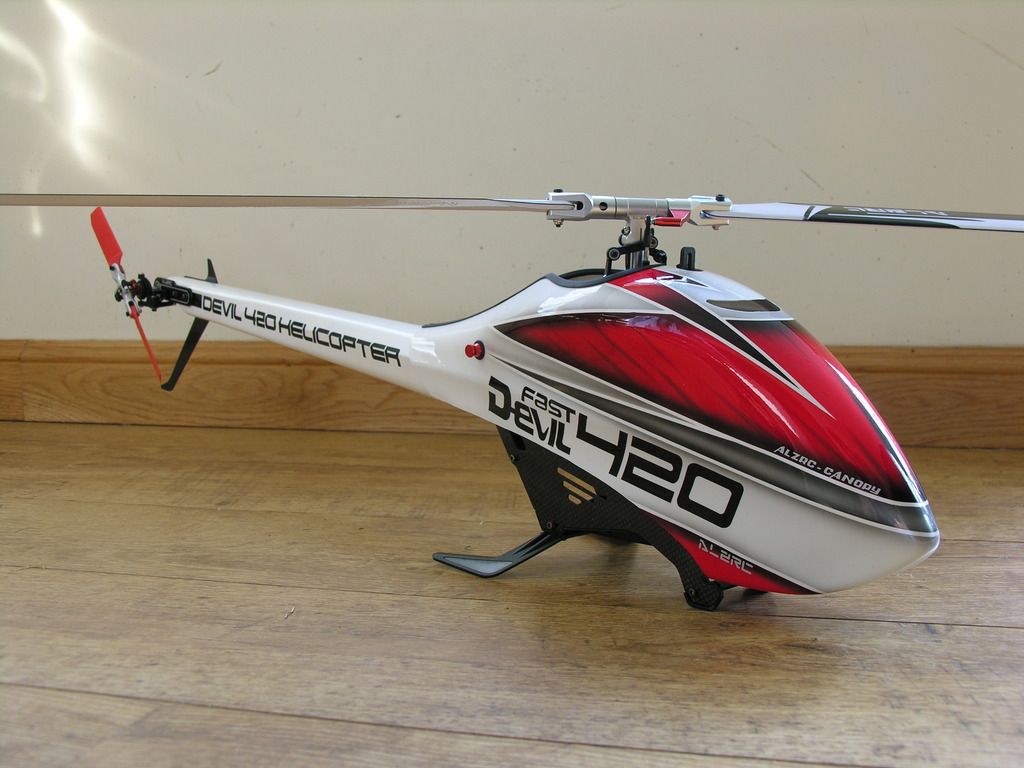

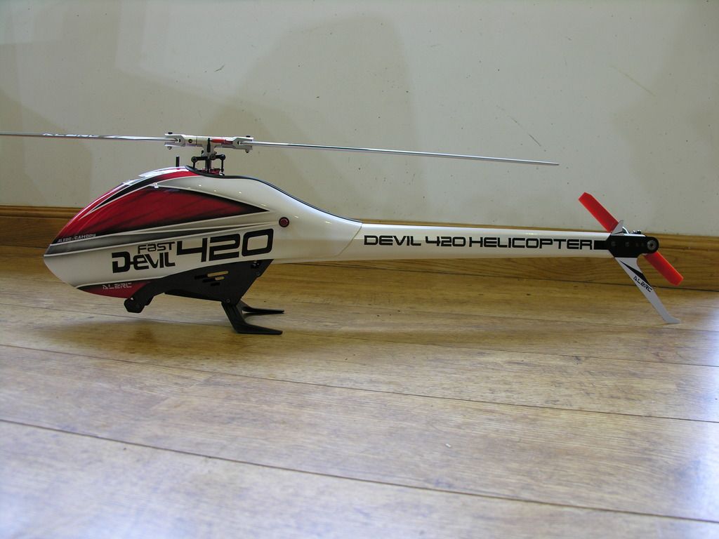

Here's the devil 420 built except for electronics installation. Other than the fit of the boom and a bit of confusion over the difference between the main shaft design supplied vs that shown in the manual, it was all a very straightforward and enjoyable built. The quality and fit of all parts was first class. I think she looks great too:
Cant wait for the electronics to arrive...
Very nice. Looks Good, I like it :D
Can't wait to see her fly :)

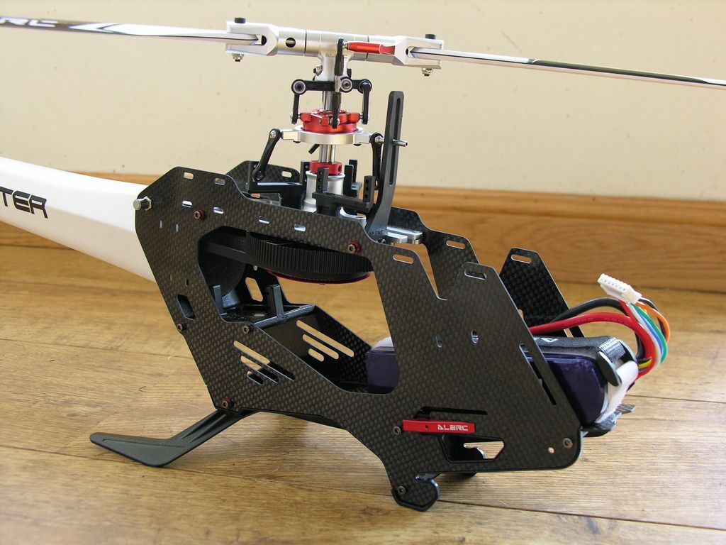

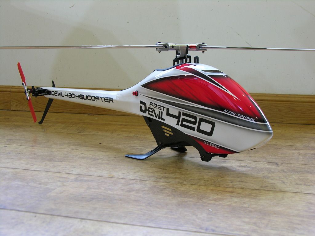

Someone pointed out that it didn't look right tilted back and resting on it's tail fin... so i suck a battery in to get it sitting right on it's skids:
No more build progress to report as I'm still waiting on the electronics.

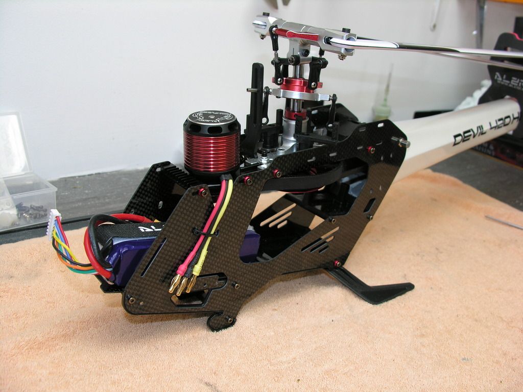

The ALZRC motor arrived today, it looks very much like a Scorpion! here is is installed and the drive belt fitted too:
Unless you want some work, do not try to shorten those leads. I have seen hard epoxy coatings, but this thing, holy crap. I wish I hadn't shortened mine because now I'm worried about a cold join in the bullets which is why I really do not want to fly the goblin. These things suck at auto's.
Smoggie
I always advise anyone never to attempt to shorten motor wires, for at least the majority of motors that have multistrand wingdings. It's almost impossible to remove the lacquer on all the hair like strands and if you dont get it off all of them you end up with only some of the wires conducting, which is a recipe for a burned out motor. I've heard that if you put the ends of the wires on an Aspirin tablet and heat with a soldering iron there is a strong acid given off that takes off the lacquer, but I've not tried it (the fumes are very nasty apparently).
