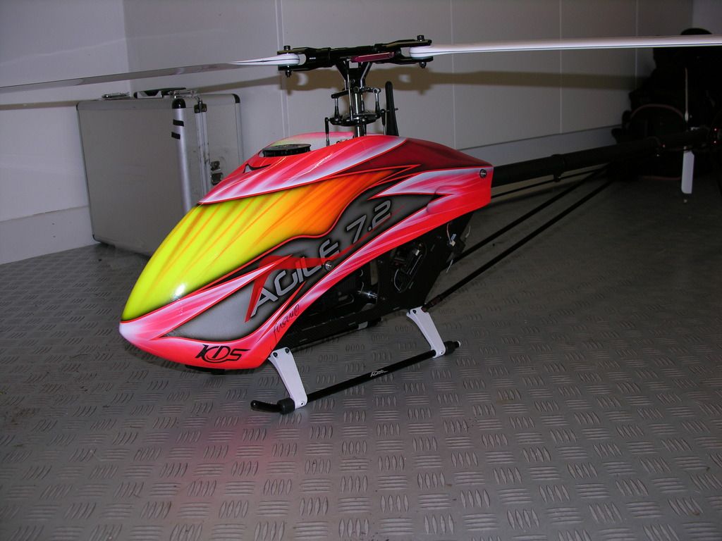

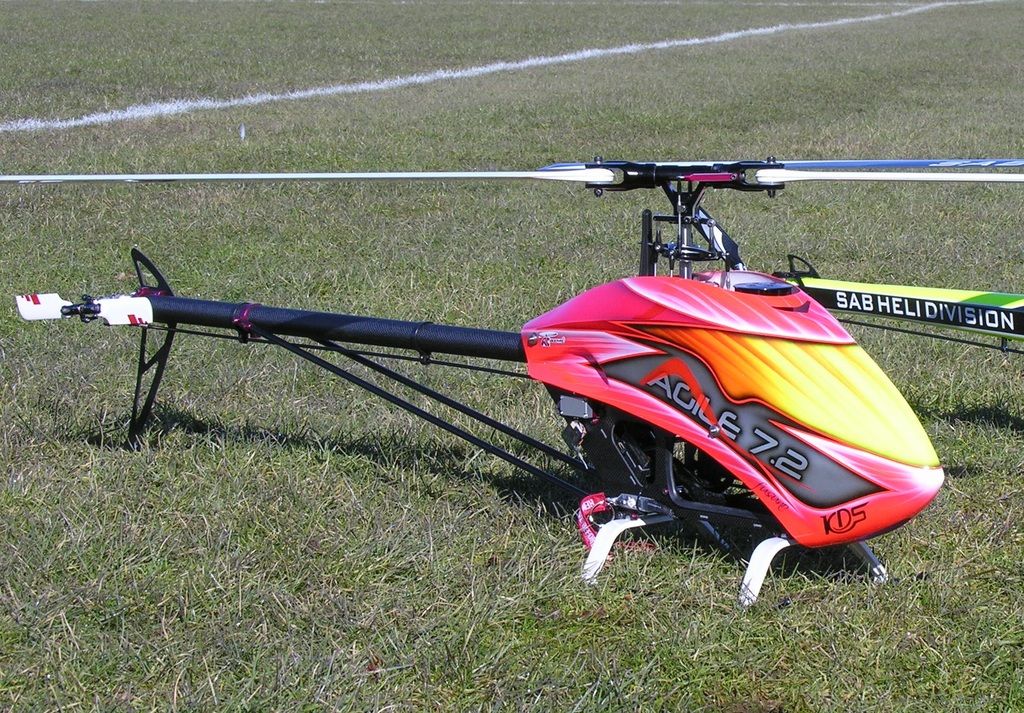

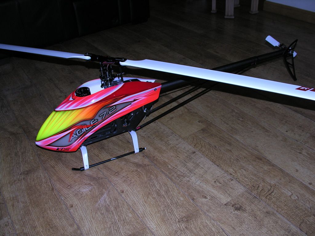

Took me a bit longer than expected, due to laziness rather than any build problems, but it's finished!

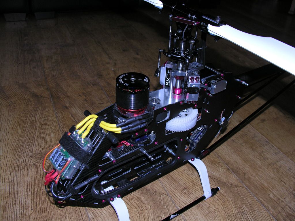

Build spec is 'what I had laying around':
FBL: Vbar Blueline
Servos: RJX HV
ESC: Rotorstar 120HV (same as YEP) with YGE heatsink
Motor: KDS BL4725 540Kv
BEC: Gryphon 7075LMT 'Quasar'
RC: Spektrum sats plus TM1000 telemetry
I've got headspeeds set at 1850, 2000 and 2150.
I gave it a quick shake down flight during my lunchbreak and it seems to be flying very nicely and running smoothly, but the conditions were terrible so it was just one very easy going flight. Hopefully tomorrow will be better.
