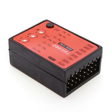

As for recommendations, upgrade your gyro... Seriously. Even the knock off MicroBeast clones are better than the 3GX. You will have nothing but issues with it. Below is the gyro I'm speaking about...

I would like to order this knock off unit . Have you heard good things about this one ? Is the typical set up the same as the mini-micro beast . The price is right . I`m not holing much funds .

Yes, I have flown the one I linked and it works quite well. And the setup is exactly like the MicroBeast.

Was looking at specs. Can I set up on screen or on unit only
Can I use instructions from the microbeast x
They say pots are different what does that mean.

I'm with Tony the TGZ 380 works well as do several other Gyros around that time, even the Turnigy 3D-H all of which were BeastX clones.
