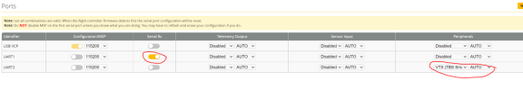

Now I have trouble with another drone :)
I've bought Darwin tiny ape freestyle for my son.
It came with a built-in ELRS receiver. I took off the antenna and sodered in the R81 receiver.
I bounded it to the TX12 Mk2 radio. They are connected.
But in the betaflightI don't see any response when I'm moving sticks or doing switches.
Everything stays like that.
I've tried it with my second radio, T8 light, absolutely the same. Binds no issues, but the drone is not reacting to any input.

Hey there Saspens :welcome1: I'm a Spektrum guy and might not be any help but I'll give it a try. You mention the RX is bound to your Tx. Now do you know what uart is the RX soldered to 1-3 6? That must match the port section of Betaflight when programming your FC. Also, I would update the FC to the newest version better yet go into Betaflight and into Search and type in version and update the firmware to the version it gave you in Betaflight. One more thing I would set my low end to 1000 center 1500 and high 2000 just my :2c: and I hope this helps some and does not confuse you :).

I found it:arms:
So I've compared my tiny ape drone settings in Betaflight to baby ape pro, and I saw some differences.
After I changed how there 1686714562975.png and everything worked :)
I have no idea what it is, why it was not working, or why those two changes made it work.
But now I can see all the input in real-time.
P.S. I've tried to update firmware but could not: stack with the "Failed to open USB device" error.
Glad that I didn't have to, but I guess it might be a problem in the future :biggrin1:
I believe what I've found has something to do with what you said :)
