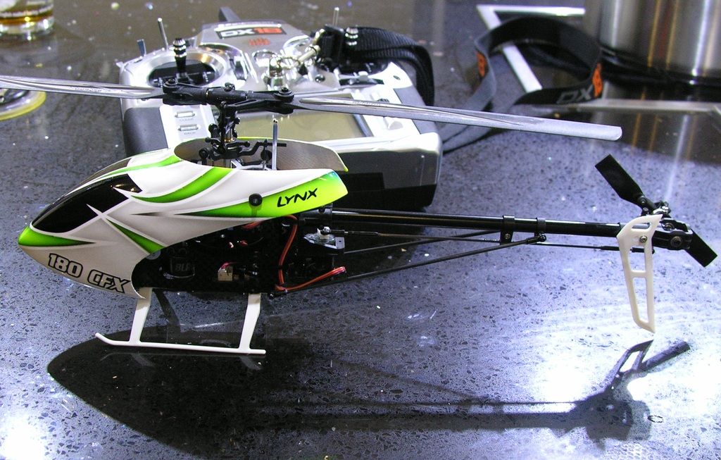

I had changed out the tail shaft as well, I didn't mention that but with the crash I toasted the tail servo and when I changed that out I flipped the tail shaft for good measure assuming the worst
. I swapped out the main blade hub because I thought there was more movement there then before, so put the stock one back in as I figured it may have got stretched on impact. The Jesus bolt for the hub itself was definitely bent, and since then it looks much better as I mentioned, almost completely gone with the bullet blades.
