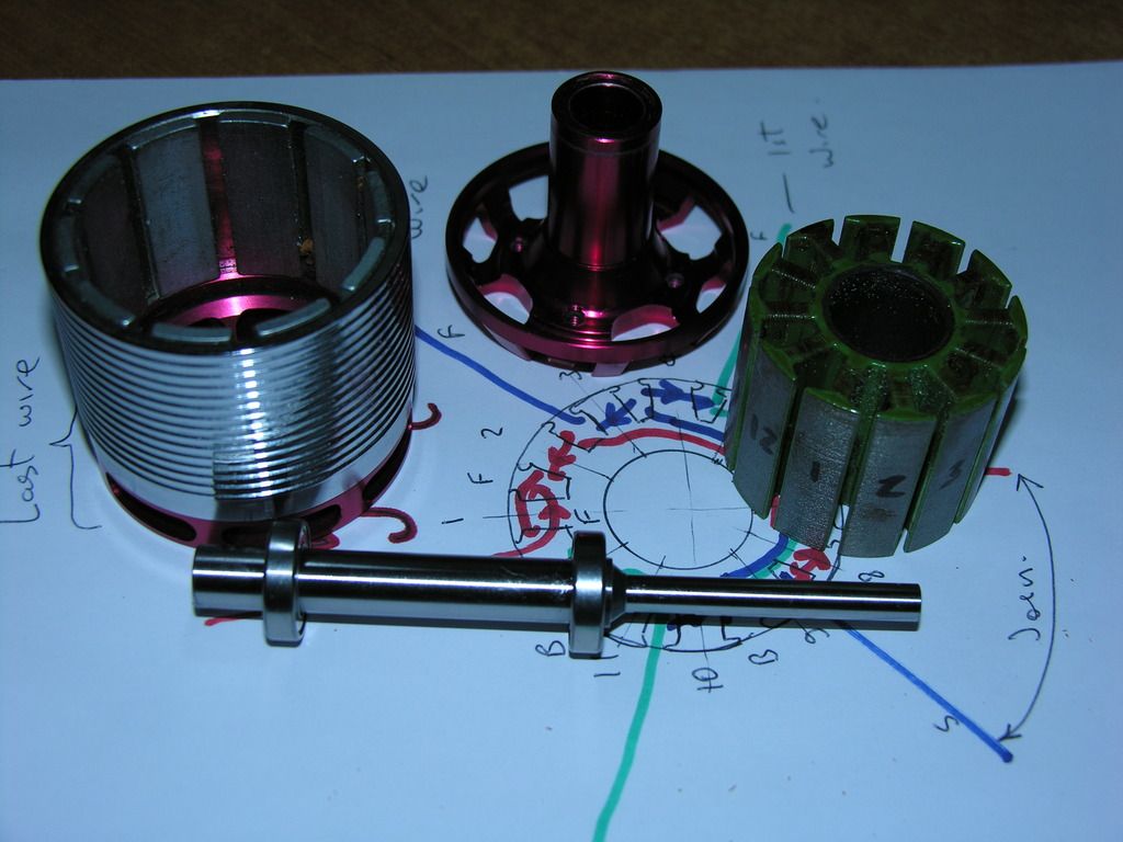

So that involved buying some 1.5mm copper magnet wire and other bits and bobs. I've re-wound smaller motors before but 1.5mm wire is hard to bend and I discovered needs some specialist tools to get tightly wound on the stator, so I've ordered those too.
Anyway, at the moment the motor is broken down to it's component parts, original copper windings removed and awaiting the special tools so I can start winding it again with the 1.5mm wire:
The jury is out on if I can ever get it working again but the attempt will keep me out of mischief for a little while.
